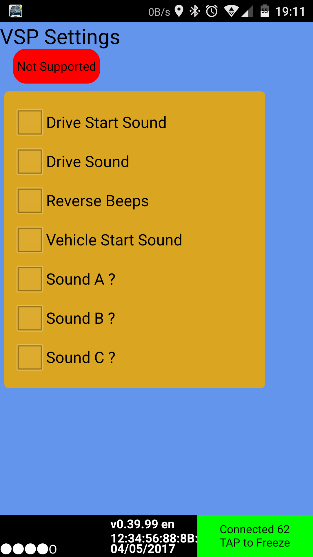

- VETL
- Mensagens: 4068
Re: disable VSP sound by software
No meu mk1:
